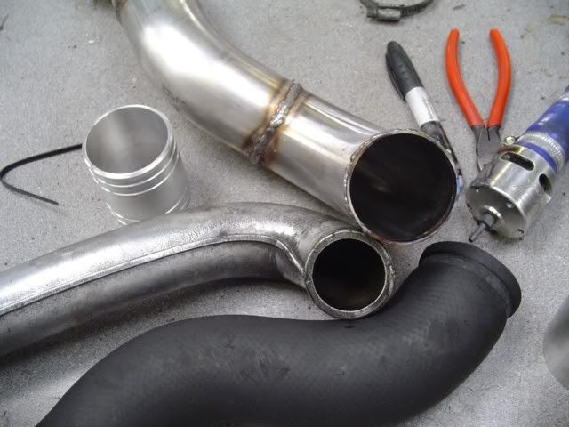

    custom made stainless steel intake pipe with old cast alloy one

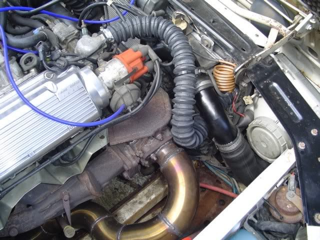

    part of my 3" front pipes

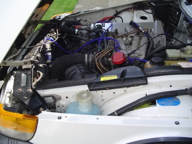

    under bonnet

    What have you done to give the valve cover that "dull" shine?

    G'DAMN your valvecover was sexy...

    I've been thinking about adding more airflow to my FMIC for months now.
    so I modified the bumper ie no numberplate
    I have only removed the "ABS" plastic bumper skin at the moment & removed the solid foam inner block. I'll finish it later this weekend

    I see that you have put the 1987 bumper on it.. I like the engine photos.. I have never seen a cleaner engine...I want to see more phots of your good looking saab... Sorry for the english.. i´m not so good at it..

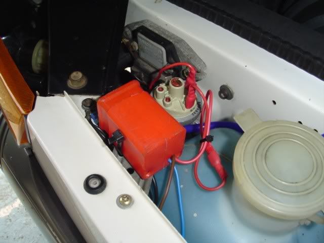

    my intercooler misting kit
    my 3" front pipes & new route of my intake pipe to the FMIC
    stainless steel intake pipe to throttle body note the APC unit, is moved cos the intercooler misting kit sits where the APC unit was
