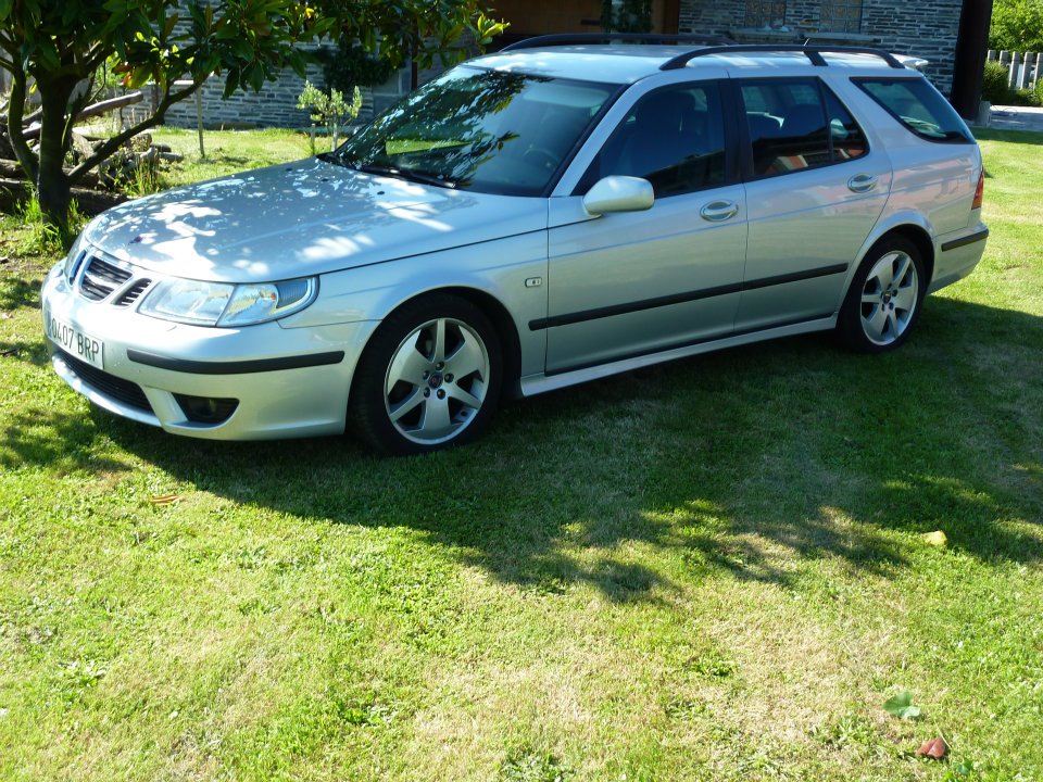

    Because of the environmental restrictions that are being implemented in spanish towns and cities I can no longer use my MY02 9-5 SW 2.3t (B235E) in lots of places.

    I love my Saab and it would be an absolute shame having to scrap it, it has zero rust (always in a garage) and loses no oil at all.

    The frustration comes because my 9-5 was garaged all her 21 years, and spent all her life in a mild climate with no salt on the roads, there´s zero rust, I have spent thousands to keep it in excellent condition, hoping to keep it like people today keep an OG900 in excellent shape.
